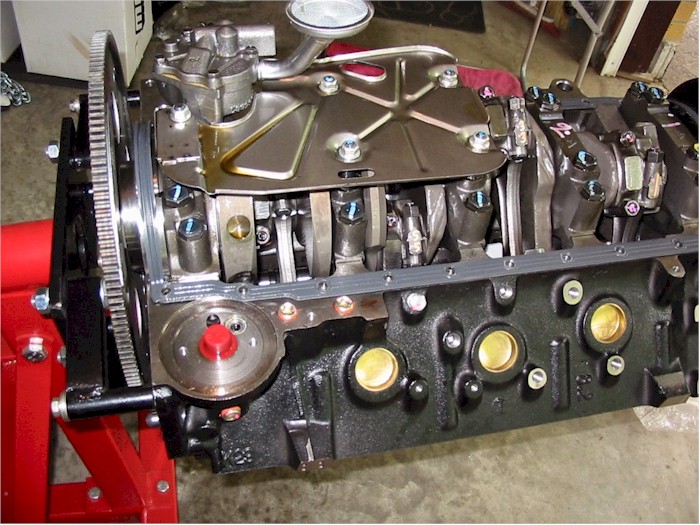

You sure know how to put a smile on an old car guy's face. I ran one of those windage trays on our old L72 engine for many years and still have a set of studs that I will use when I get around to putting all the parts together to build another '69 L78 engine. Every little bit helps. I also used the steel heat shield that snaps in between the heads to keep the hot oil off the bottom of the intake.
That's the shield. Our L78 worked best with the carb heat shield, the under intake shield that you show here and the heat cross over blocked. For summer running the intake gets plenty of heat without adding any more and aluminum transfers heat a lot faster than cast iron. The low octane of today's gas doesn't help much either. The aluminum heads do help some at warding off detonation. Love the pictures. :)
Uh-huh. :D
Oh, and the ZZ502 intake has no heat cross-over cast into it at all.

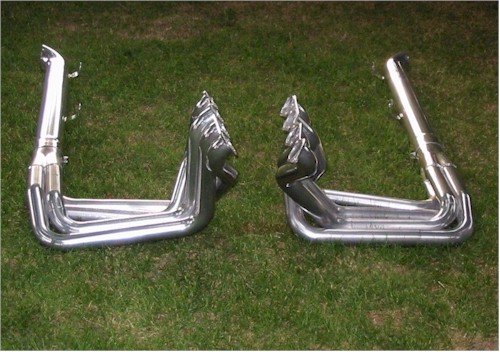

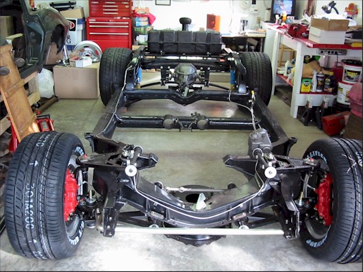

My '67 L-71 already had an aluminum intake under the 3x2 Holleys, but the ZZ502 adds aluminum heads and an aluminum water pump. Those, combined with the high-torque small starter, a new aluminum rad with electric fans, a monoleaf fibreglass rear leaf (rather than 7-leaf iron), a monoleaf fibreglass front leaf (rather than heavy coil springs), lighter (but stronger) upper and lower A-arms, Hooker headers (rather than cast iron exhaust manifolds), etc. have combined to drop the weight of this car by over 250 lbs.
Mind you, I did substitute a heavy Lakewood scattershield for the aluminum bellhousing (I may be crazy but I'm not stupid). Also, I've put on some weight in the last 45 years. :rofl:
I always wondered what the savings would be with each component.
You save 82 lbs on a pair of BBC heads alone. Another 10 lbs on the water pump, and so on, and so on.
These weigh substantially less than factory cast iron exhaust manifolds, pipes and mufflers.
Lift a pair of front coil springs and then compare them to a monoleaf fibreglass spring. :D
WHAT A BEAST. I love the look of this Vette. Awesome menacing stance.
That's how it should have come out of the factory.
Thanks. I appreciate it. I put several years of work into the design and the build. It was a very long and difficult process, but the satisfaction after completion was worth the effort.
