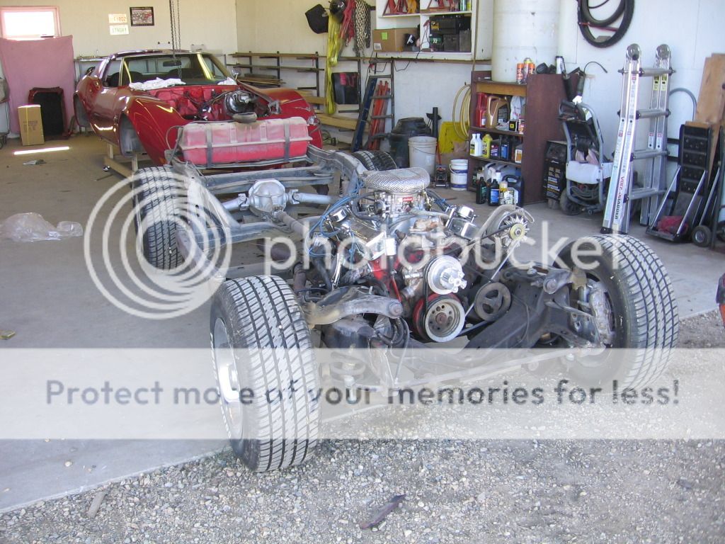

yup, you need 4 tires alright. i have cooper cobra 255/60/15 and like them. any good tire shop can order whatever tire you like.
+1 on the Cooper Cobras 255/60/R15. But i had to go 245/60/15 in the front to avoid rubbing. From 78 on the 255 will have no trouble fitting but earlier it is hit and miss. I have seen other guys with 73's running 255 on all four but i was not that lucky.
