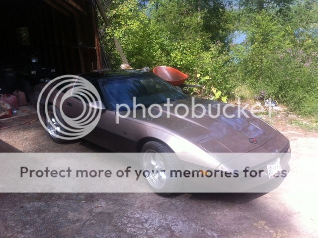

Thanks for the input guys! I went with an aftermarket rim and some goodyears. I will post pics next week.
Thanks again guys ,
Bryan
There it is pretty much like the rest of them lol
Thanks for the input again guys!

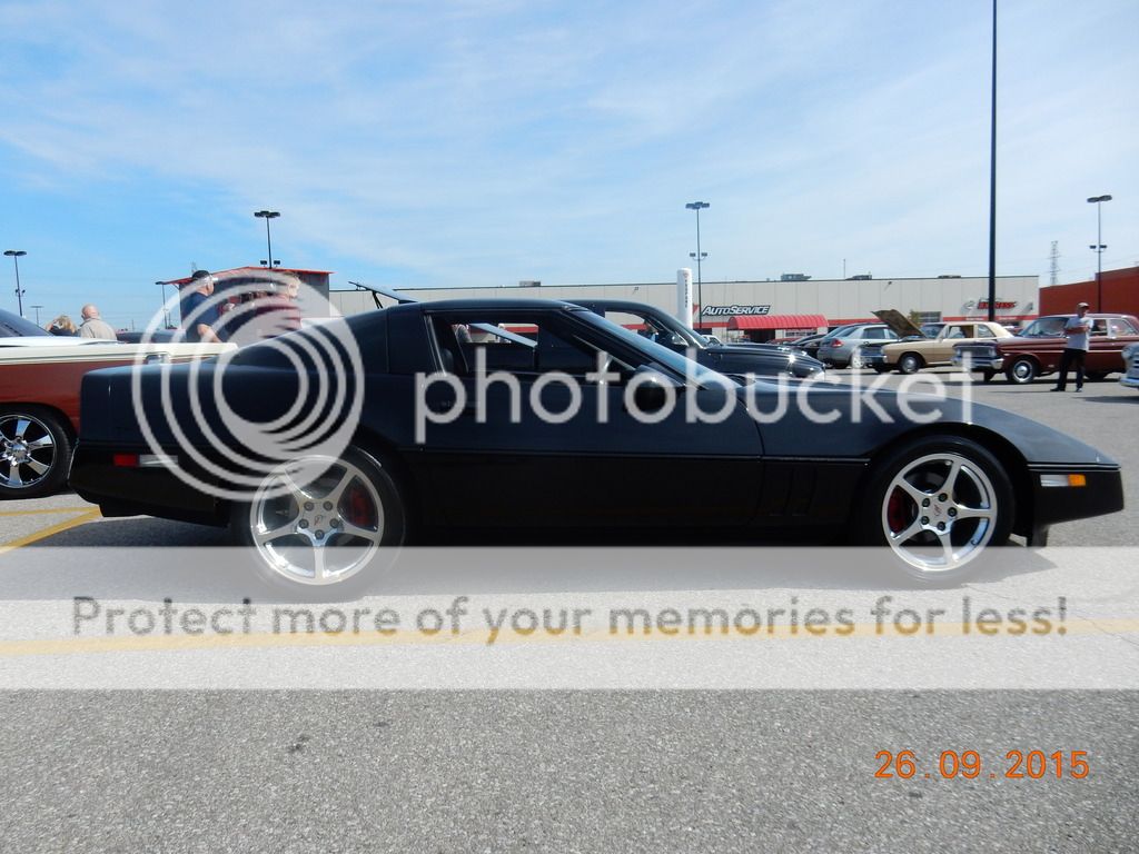

Oh man you picked some nice ones.
Those rims look really nice on the car. You done good. :thumbs:
Sorry, I win the Internet today...C6 Speedlines.......until someone puts C7 rims on theirs.
Just for clairity, 84-87 have different backspacing and require HUB ADAPTORS, not SPACERS, not the same thing. In the above, 19" rear has a 1.25" adaptor front 18" has nothing...'88 Z51
