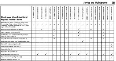

My 2021 C8 will reach 12000KM and will be 3 years old in a few months. The owner manual instruct to change the transmission fluid at 72000KM or 3 years (see footnote 4 in attachement). Currently my transmission oil life is at 78%... far from 0%.
So to be sure not having issues in case of future warranty claims... I will be changing the DCT transmission canister filter and fluid. I saw many threads about the cost of changing the transmission canister filter... but couldn't find the price to also change the fluid... so my 3 questions:
Q1- Are you guys following the owner manual and changing the DCT transmission fluid at 3 years even if not reaching 72000KM?
Q2- What is the cost of ther DCT transmission Fluid and filter change?
Q3- Should I take the opportunity to ask for 2 extra quarts of fluid?
