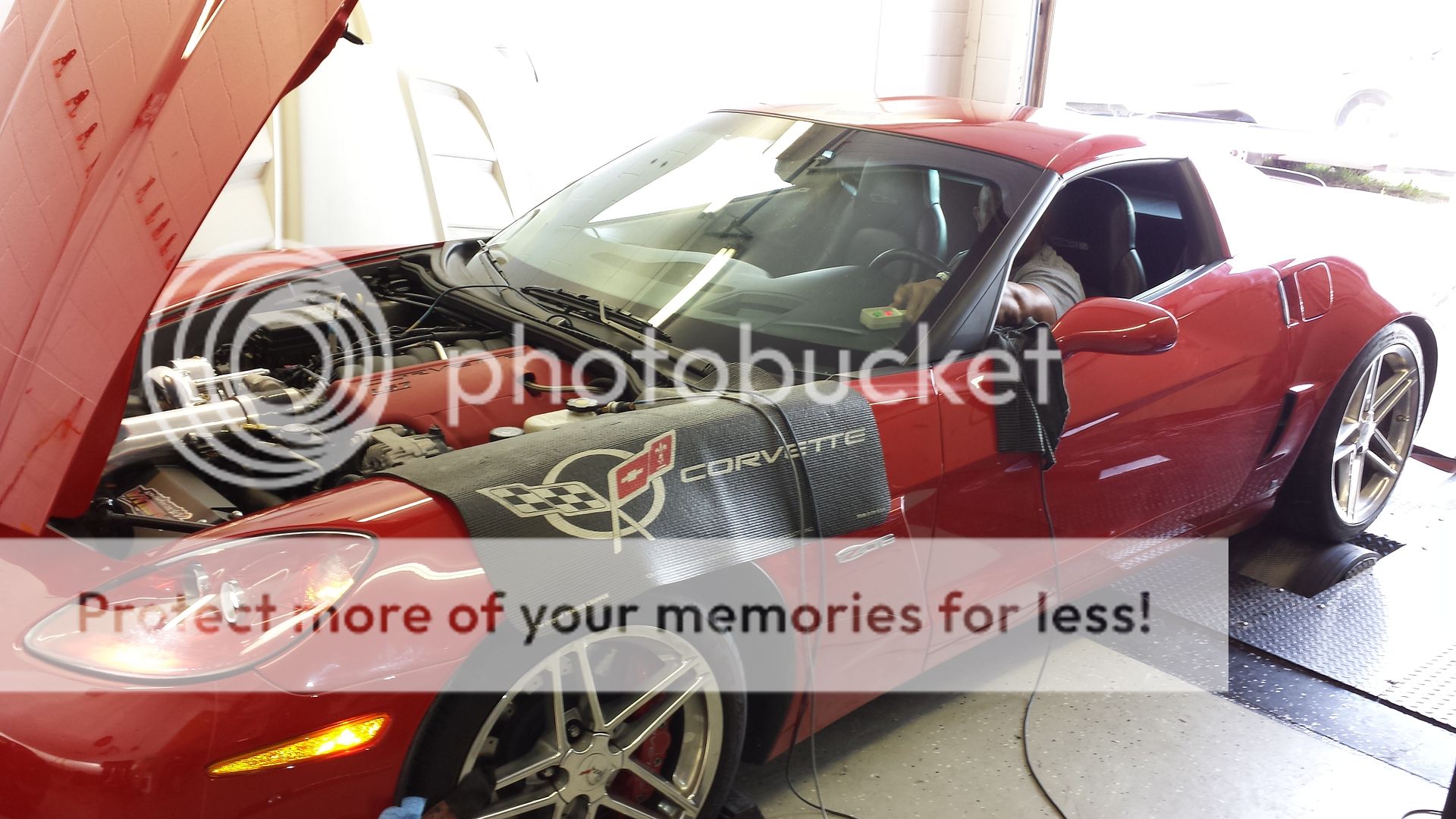

Here is another fine example of the Dasilva Motorsports Supercharged C6 Z06 :
Mike contacted us about building him a strong C6 Z06 , that would be able to run on the street as well as the track.
We started by first doing our signature LS7 heads , and good thing as his with 49K we showing the typical signs of valve guide wear .
Next we added a set of Pfadt Racing's Tri-Y headers and high flow cats and 160 stat.
The headers were needed to move all the gases created from the ECS Supercharger and Alky control Meth injection with a custom rear mounted meth container and pump .
We also used a Dewitts rad to help keep the temp safe .
The results are a well balanced and safe build .
