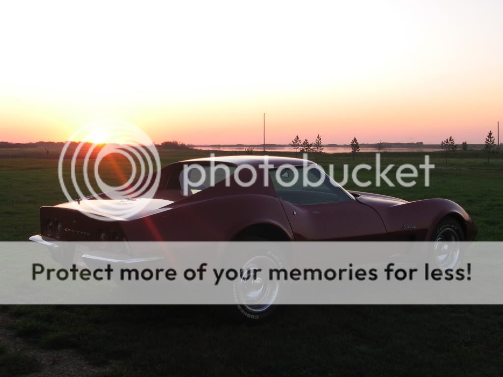

On my 73 I ran Cooper Cobra GT. 255/60/15 Rear and 245/60/15 Front. The 245 still slightly rubbed on the sway bar at full lock and 255 would not have cleared the bottom point of the fender (could have been trimmed). No issues in the rear. I liked the look with the slightly smaller tire up front. And ya I have learned that no 2 cars are the same when it comes to tire fitment.
Best Pic I can find right now. Consequently also my favorite pic of my car.
