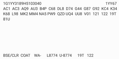

Hi, I ordered my buildsheet and window sticker to know the original options of my car and to make a repro of the RPO decal.
my question is: which codes should be there and not ?
The codes of the window sticker and the buildsheet are not ALL the same.
For exemple, manual transmission on the window sticker is MM4 and the buildsheet is MK2 which one should be on the decal ?
Also the diff codes, G92 on window and G44 and G87 on the buildsheet.
My guess is the buildsheet codes should be on the decal but I need to confirm that with some experts.
