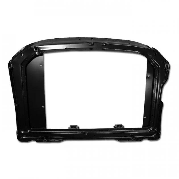

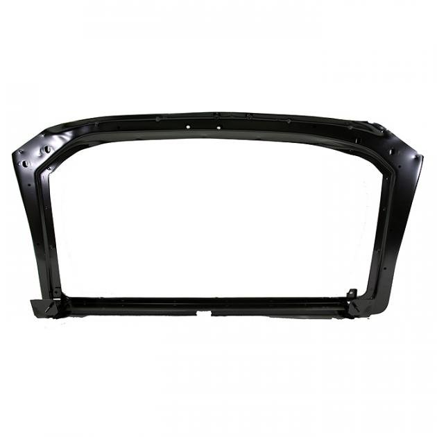

This does reassure me, so thank you. For the aluminum radiator support, I meant a radiator support that would work with an aluminum radiator. Just from looking online at various suppliers, I found that there are radiator supports that work for only copper radiators. The radiator support I am looking to buy is from Corvette depot,
In the product description, it does say that it's a reproduction of the original so I think it should be good. The only downside is this support is for no air. I haven't been able to find one with air.

I looked into the M-4208B, and I found the exact same part on Corvette depot
but on there it says that this support is for copper radiators only.
