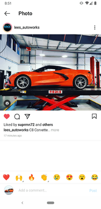

My Stance wheels arrived in the 19/20 setup. Thx to Lee's Autoworks for the swap of stock rubber onto the new setup. I'm planning to lower the car slightly to reduce the stock wheel gap.

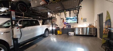

Then I installed a 4-post lift yesterday. Just waiting on Home Depot to fulfill my 5/8 Concrete drill bit order then installation will be completed.

If the floor isn't level I certainly wouldn't bolt it down. Let the posts walk a bit and find their happy place. There is an 1 1/2” difference on mine front to back. No issues or worries.
I've done that moving the lift up and down a few times. Seems to have settled where they are now. Very slight shimming required.
Do any of you have the center rolling jack for your 4 post lifts? Was just wondering if the arms on the jack come out wide enough to reach the C8 lifting points
77 " with a two inch front level kit. Max height of lift is 82" but the fixed locks are at about every 5 inches so I have to use the max height of the lift. It seems to have a lock at 72,77,82..
And, why do you want to bolt it down? Mine is not, and I don't see the need to do so. Should I reconsider for a reason I'm not aware of?
I noticed my columns weren't exactly plumb to the floor. My worry is that they will hop.
When I have the lift at its highest setting there's a front pad gap on both columns on the wall side of my garage. I'll shim then anchor to be safe. Shims came with the lift.
