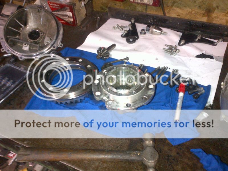

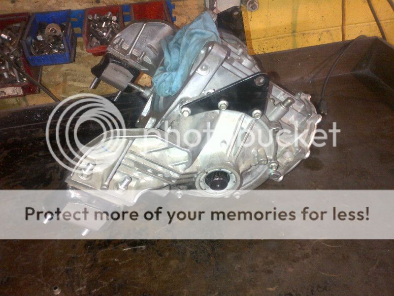

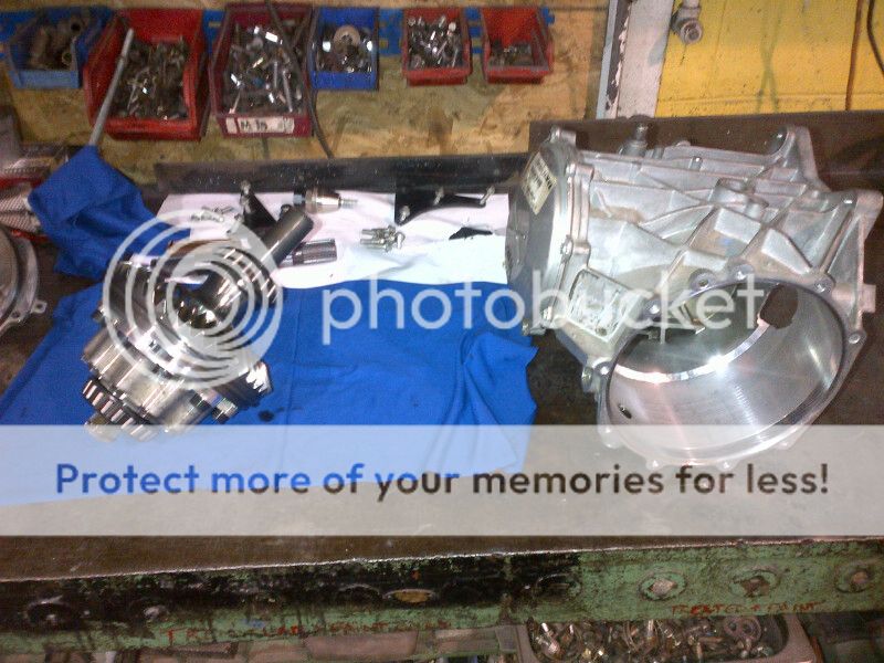

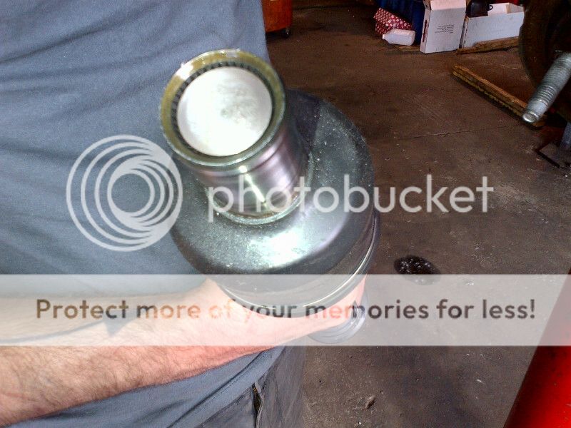

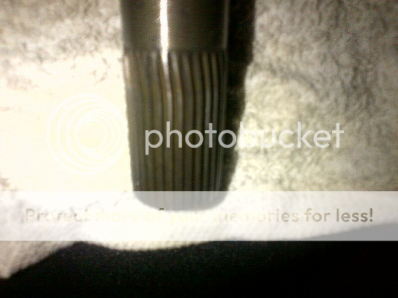

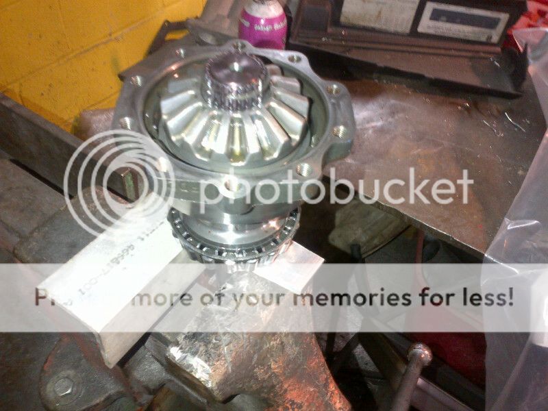

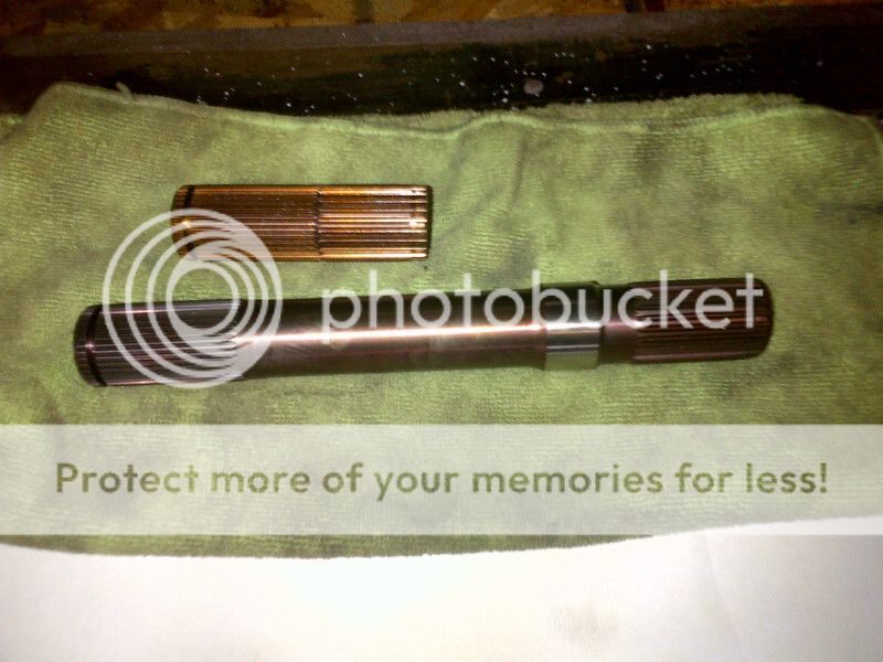

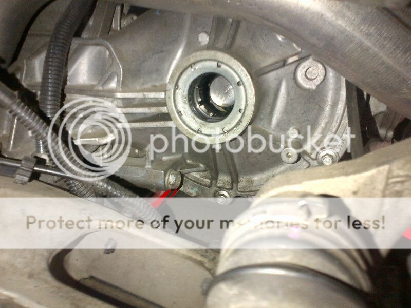

I adjusted the shift points and went to try again. Of course the thought of a nice picture (got someone to video) of the wheels lifting forced me to launch a little bit harder.... boom... broke a hardened diff output shaft. Amazingly clean break. The car was just like it was in neutral and didnt even make a sound of anything wrong, it just wouldnt move.
Time for DSS stubs... hopefully those will hold up. While its apart I am putting a billet intermediate shaft in the trans. I thought thats what broke and want to avoid that next weak link if possible.
