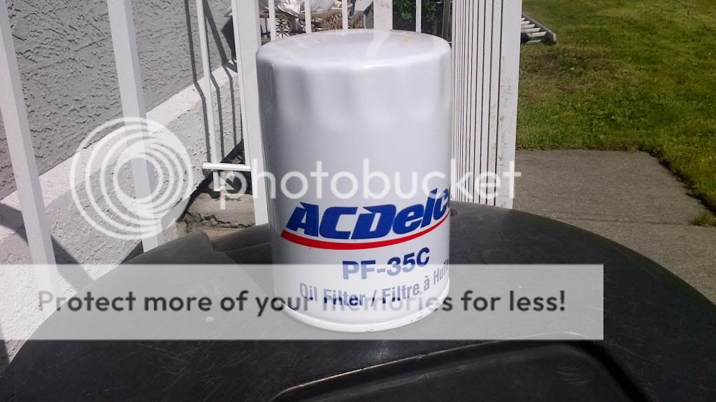

I use GM filter #PF35C. This is the 'long' filter Doug referred to. I also agree with Keith about factory filters.
