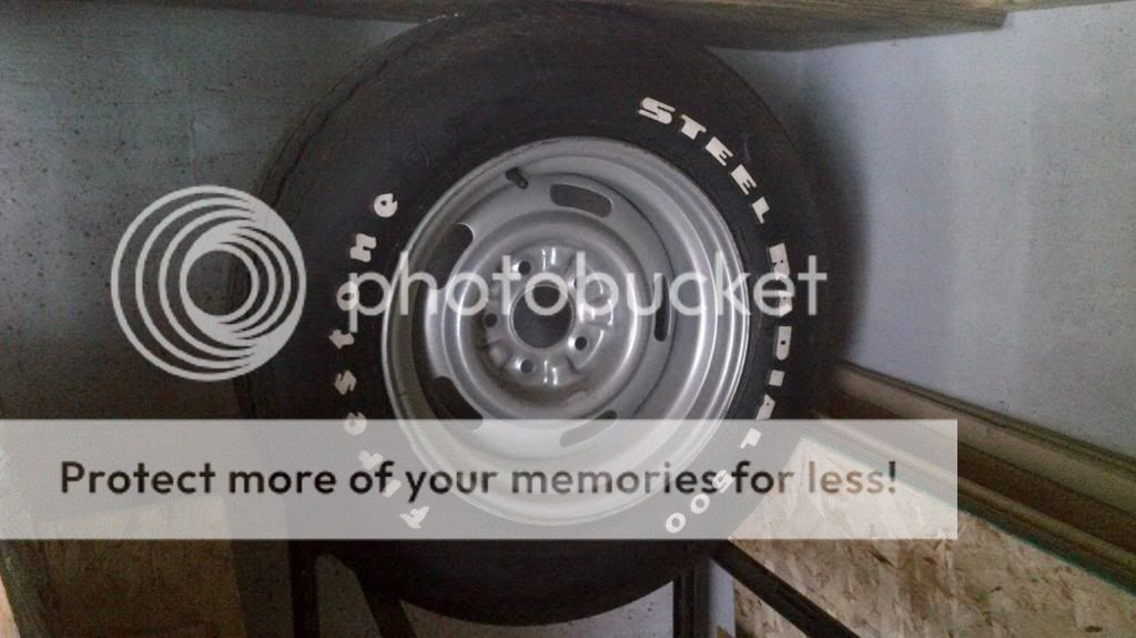

You have an original firestone 500 whitewall spare...excellent. I have a firestone 500 raised white letter tire that was given to me by a another'75 Vette owner 30 years ago. He told me it was his original spare? His car had been written-off in an accident but he had kept the spare?? I wonder if GM offered both whitewall and/or raised white letters on our cars????
I don't carry mine as a spare but do have it for serious shows where we display the spare tire.

My car was originally equipped with whitewalls according to info from GM Historical in Oshawa. Standard equipment would have been blackwall with whitewall or RWL optional. That's a nice looking spare Graham.
