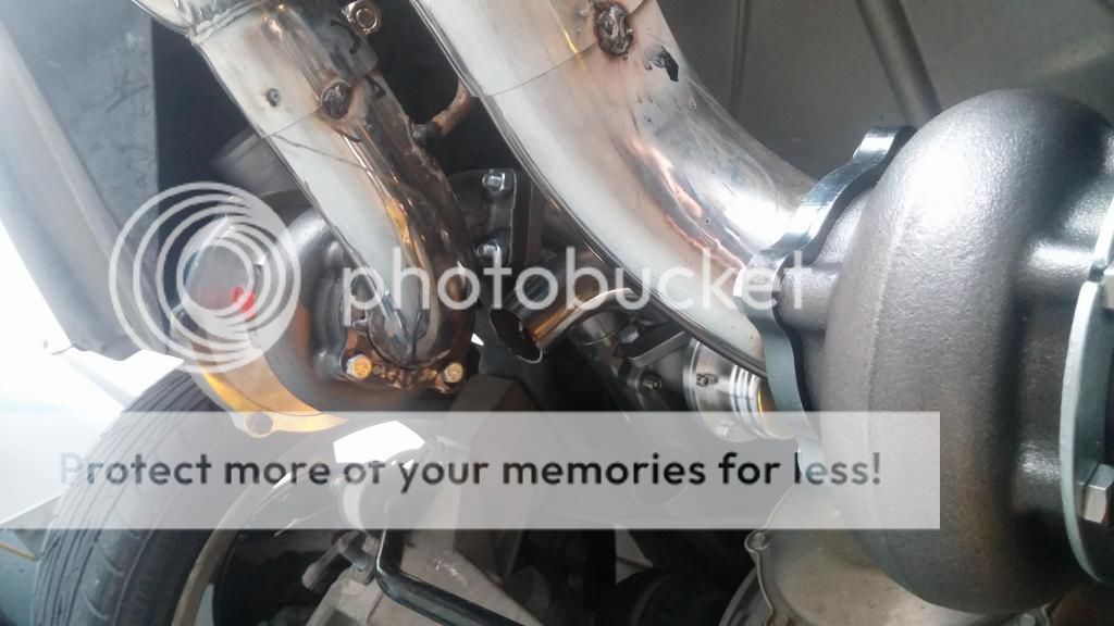

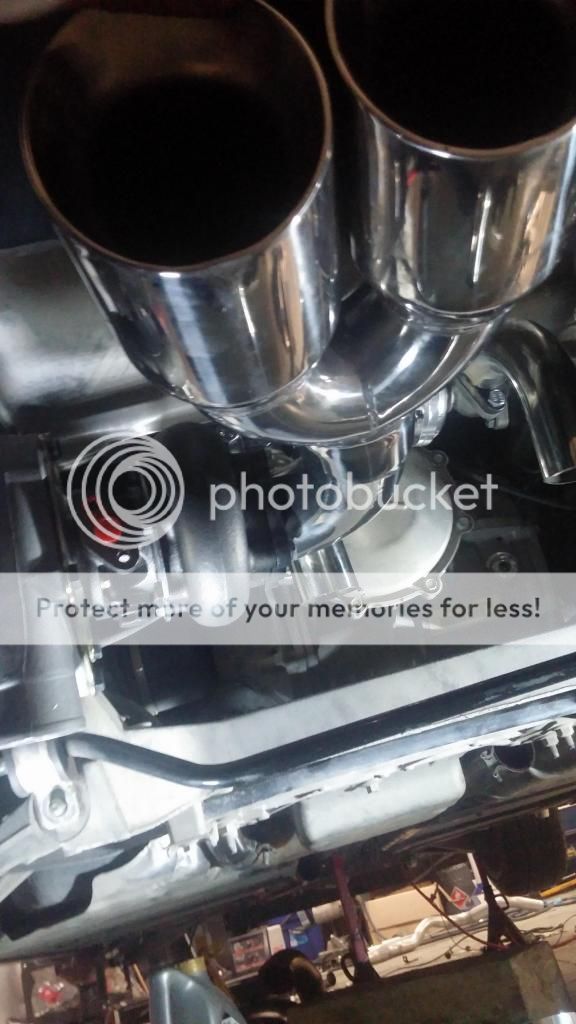

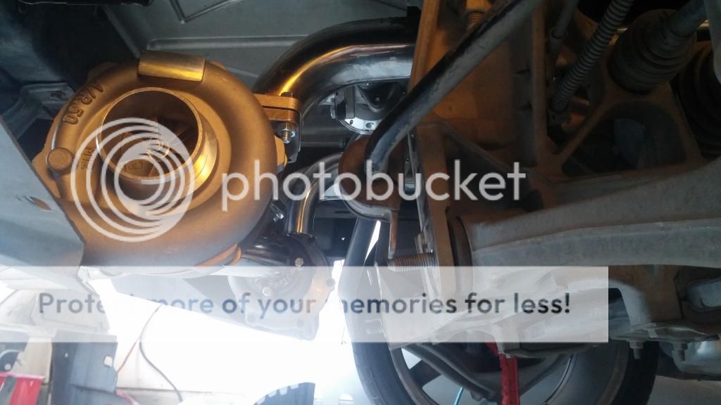

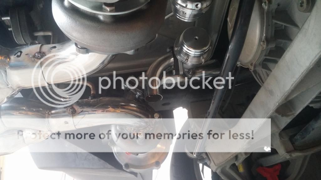

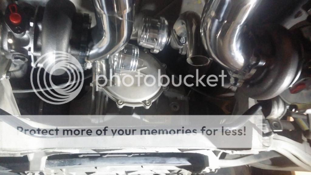

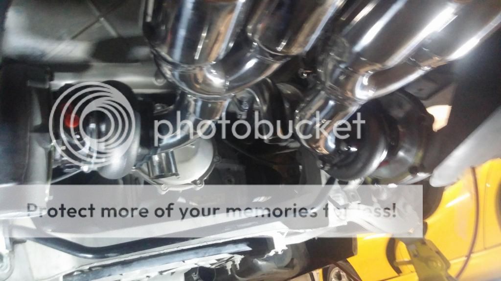

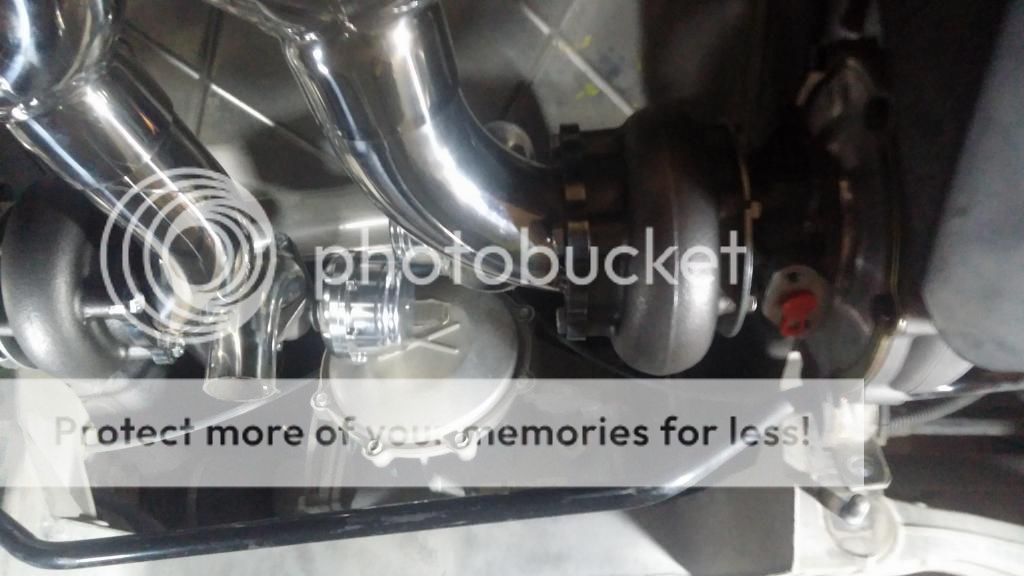

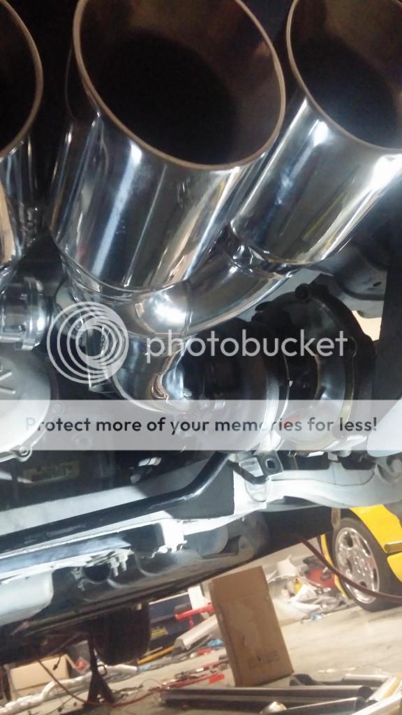

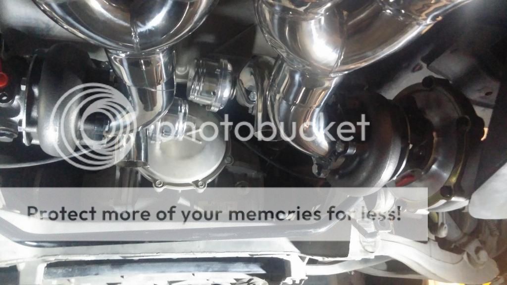

I didn't have a great deal going on this weekend and wanted to see how I would do fabbing up a rear mount set up for my C6. I seen a video of a rear mount C5 taking off on the hwy and it really motivated me. Got most the hot side scabbed together.Here's where I'm at with it. 58mm turbos, 38mm wastegates and a 50mm BOV. I'm already laughing at track officials when I trap 130mph and claim to have just bolt ons. Really they are just bolt ons.......
Did more tweeking on it for fitment.
Still need to do some more tweeking on it
To be honest Im not 100% sure. Really its not ideal for a daily driver. Everything in moderation right. But Im thinking if the turbos are not red hot (and they wouldn't be if its raining cause you cant drive the car hard) then it should be okay.......
